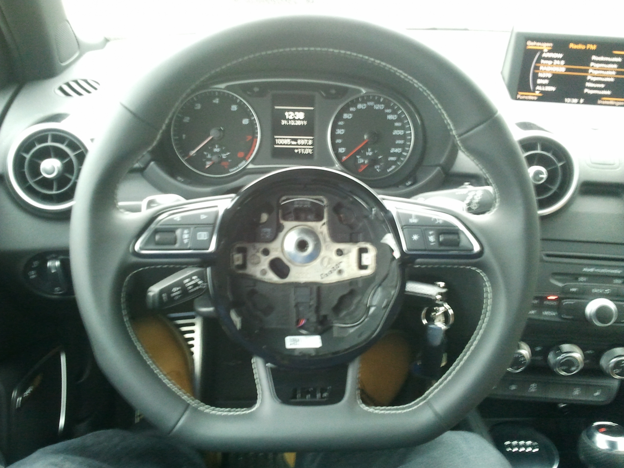

today i was busy installing my audi S5 2012 steering wheel. . the steering wheel is much thicker then the thin steering wheel we now all have. . i took out the steering wheel buttons from my own steering wheel and put them in the S5 steer because my own steer had much more buttons. . only need airbag and i am finisht.

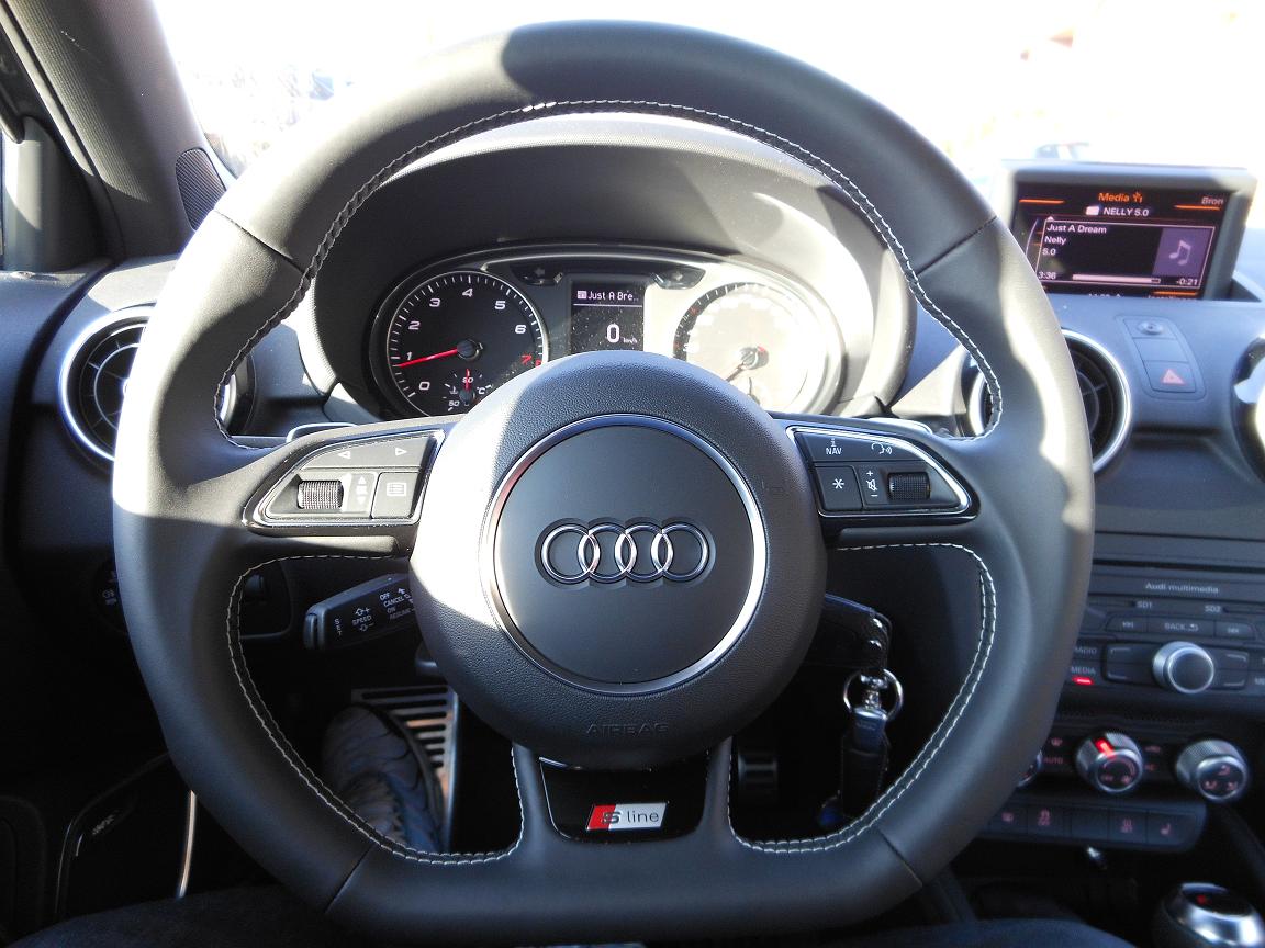

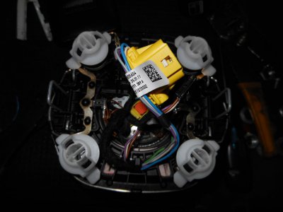

Project finisht today i did get the airbag for the S5 steering wheel , . I changed the wiring end installed the wiring from my audi A1 airbag , . took out the S5 logo out the steering wheel and intalled the S line logo. . now i am finisht . left upper picture the difference between left S5 airbag end right the A1 airbag. . right upper picture , finisht S5 airbag with completed A1 wiring . . lower picture finisht steering wheel.
