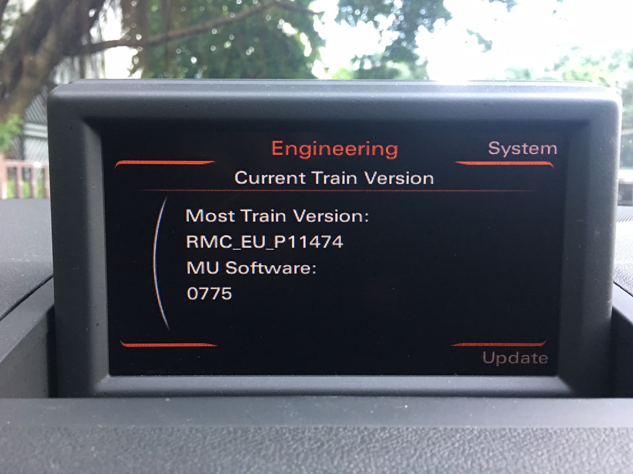

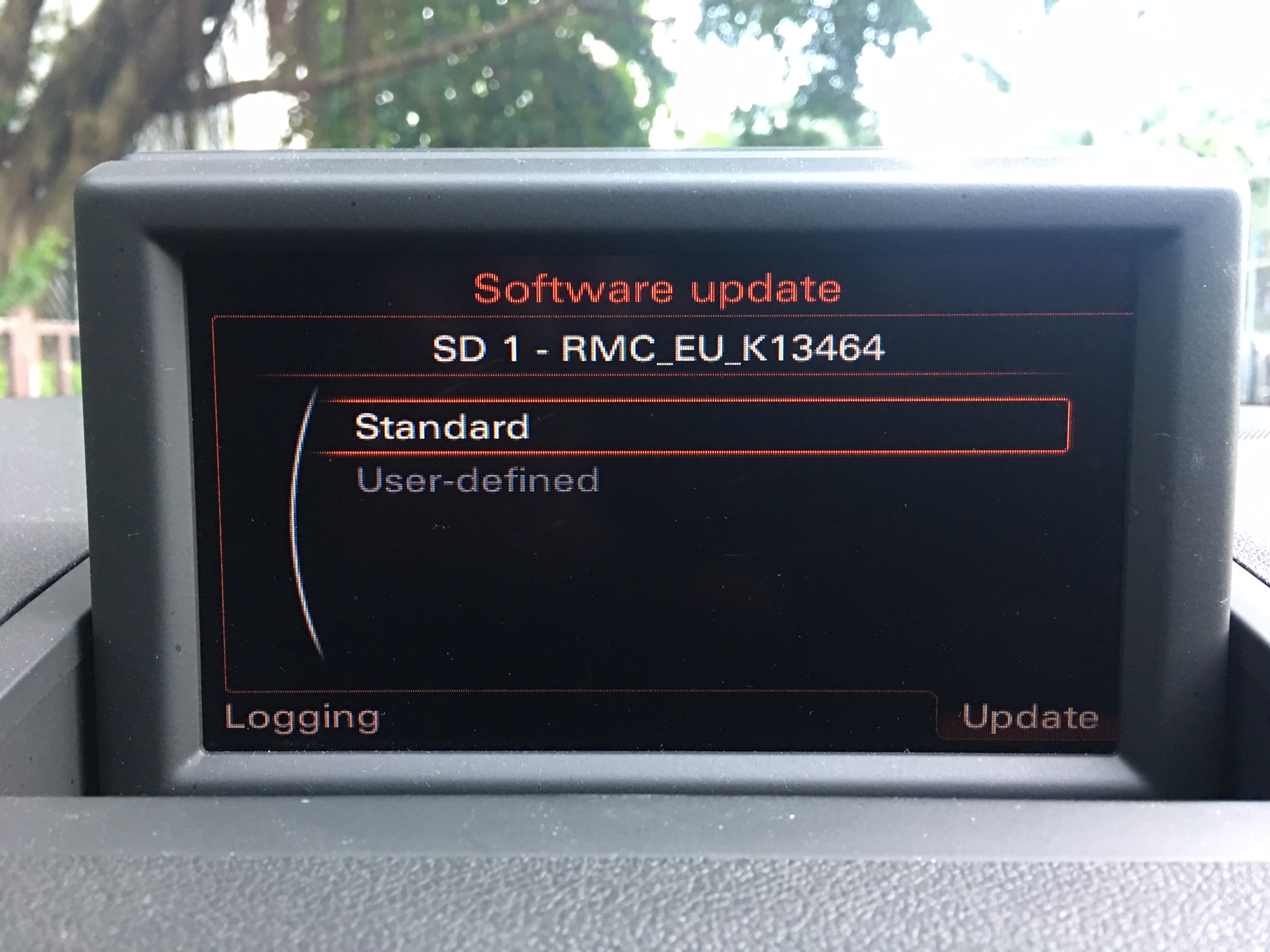

    Hello. I am on EU_P12XXX. I wonder whats the procedure of the update and any guides to update? Sorry for using English.
  9. lscangus
    lscangus Mitglied
    20.11.2016
    12

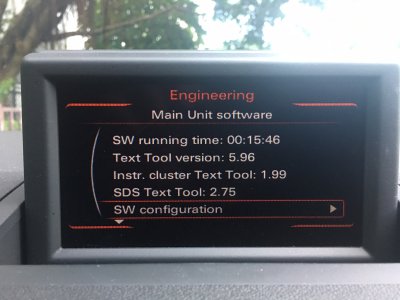

    Here are some more info of my system,and also the screen in the update engineering menu. Should i just click standard?

    Did you try to start the update?
